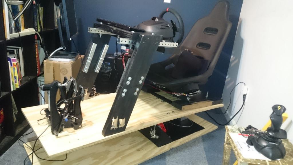

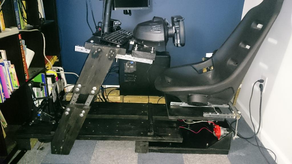

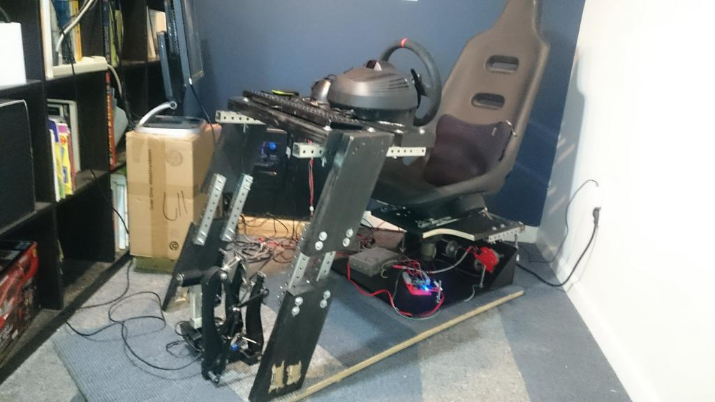

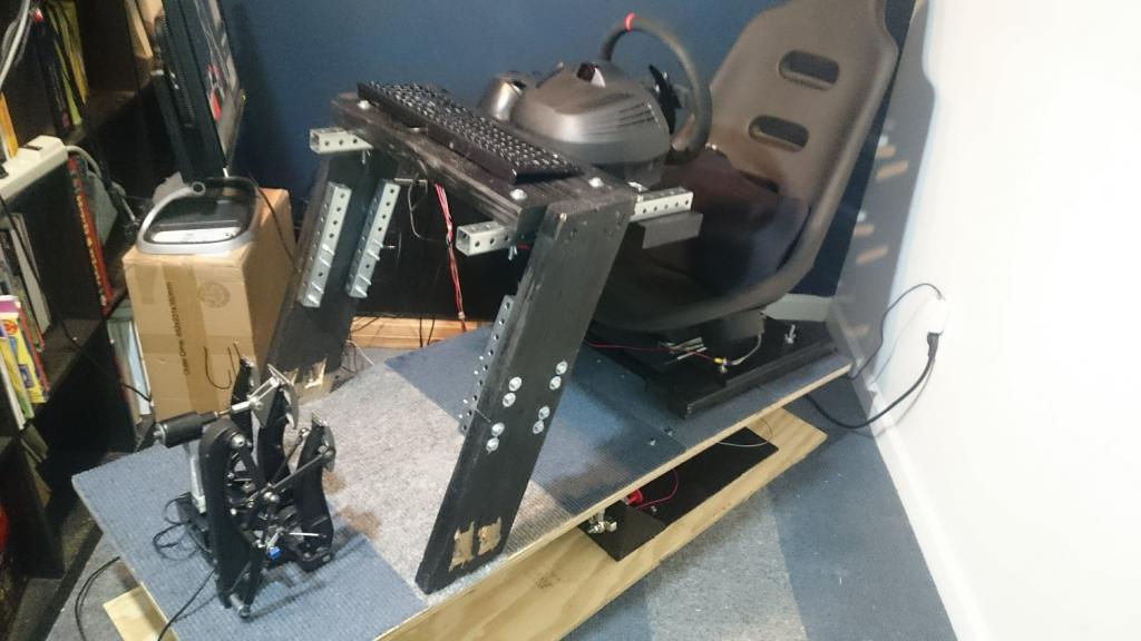

A big thanks to willaupuis and the guys at simukit for all the help with my first motion build.
For the most part it was pretty straight forward, but without their help (on all the small things I got stuck on) and specially this tutorial:
http://pcshm-simulateurs-homemade.clicforum.com/t1137-tuto-pour-les-nouveau…
I would not have made it to the finish line (although I am still not finished).
Everything seems to be working, and I am now in the beginning stages of tuning.
As iracing is my primary sim I have decided to start there.
Below are a few pictures of my rig before motion, and after motion.
As you can see I still need to adjust the height of the wheel deck - which I am able to do by adjusting the steel bars (similar to the steel bars I have to adjust the wheel deck in and out), clean it all up (making a housing for the electronics and psu), and paint it all black.
Thanks again.

painted and ready to go:)

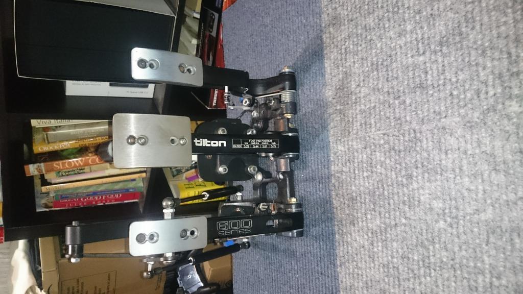

 I love your pedal set  love

Your pedals are really great !

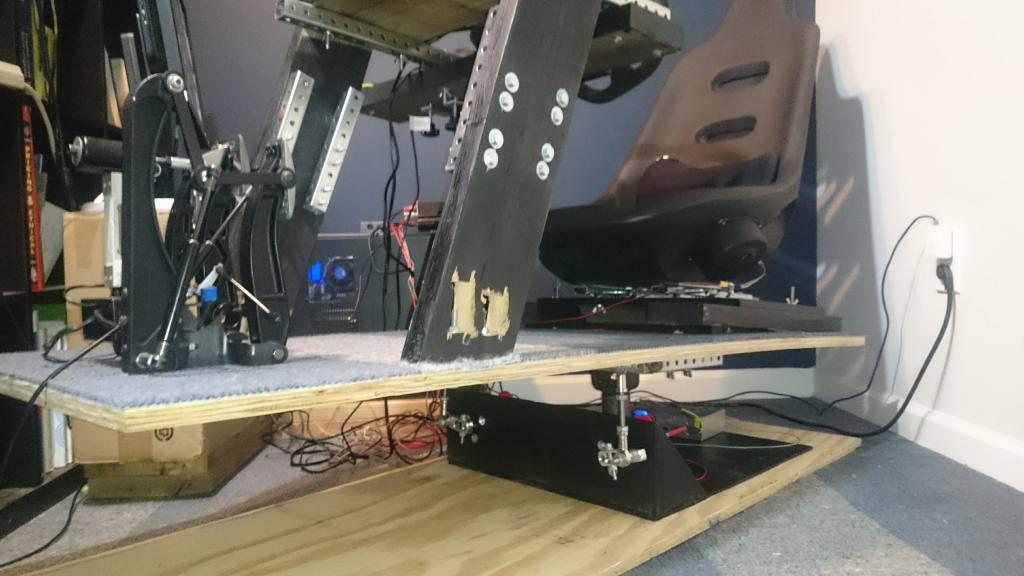

Your motion sim is very reactive, what is your feeling about motion ?

I really enjoy it. I have found I like less motion rather than big roller-coaster movements. I also decided I wanted the pedals to move. On the first build I would sometimes loose my 'feel' when the seat moved backwards. I really like the feeling of this one but I think I will eventually upgrade to the 400w motors. And yes, the pedals are great. Thanks.
